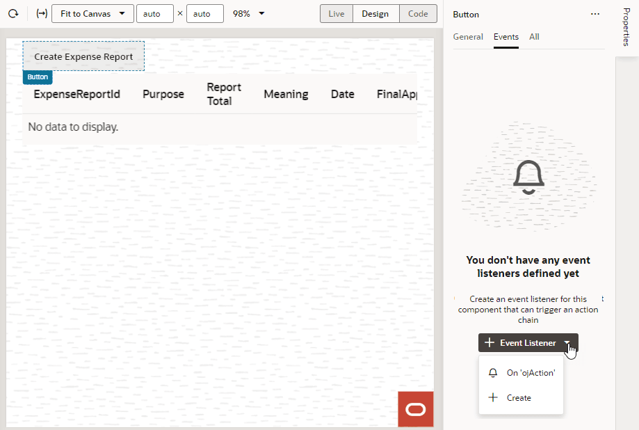

Start an Action Chain From a Component
When you add a component to a page or layout, you’ll need to create a component event and component event listener if you want it to trigger some behavior (for example, to open a URL). The suggested option in the component’s Properties pane creates these for you.
There are various predefined events that you can apply to a component, and the events available are usually determined by the component. For example, the ojAction event is triggered when a button is clicked, so you would typically apply it to a button component (you couldn’t apply it to a text field component). Each button will have a unique event and an event listener listening for the button’s ojAction event, and the listener would start an action chain (or multiple action chains) when the event occurs. Each component event will usually have a corresponding component event listener.
Note: You can add an event to a component only from the component’s Properties pane. You can’t create one in the Events tab of pages.
To start an action with a component:
  1. Select the component in a page or layout.
    Typically, you assign events to elements such as buttons, menus, and fields in form components. You can select the component on the canvas, in the Structure view, or in Code view.
    Description of event-listener-component-appui.png follows
  2. In the component’s Events tab in the Properties pane, click + Event Listener. You can choose the suggested event as a quick start or you can create a custom event to use a different event.
    When you add the new event using the quick start, an action chain is created for you and the Action Chain editor opens automatically. When you add the new event using the custom option, you’ll need to select an event.
  3. For a custom event, select the event you want to use to trigger an action chain. Click Select.

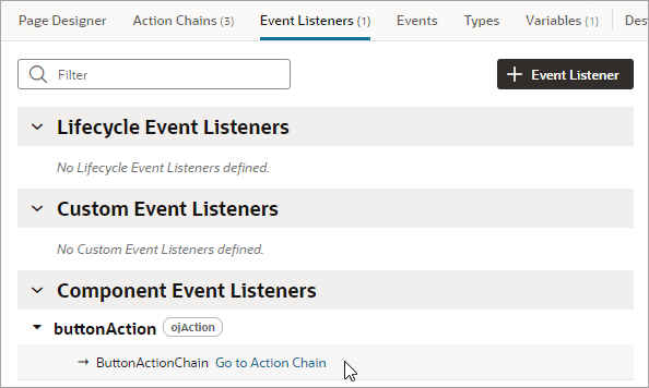

If you used the quick start option to add an event, a component event listener is created for the new event, and the listener is mapped to the action chain it created for you. If you open the Event Listeners tab, you’ll see it listed under Component Event Listeners, along with the action chain that it will trigger.

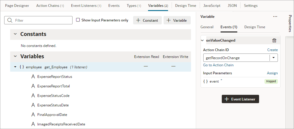

Start an Action Chain When a Variable Changes
You can start an action chain when the value stored in a variable changes by adding an onValueChanged event to the variable.
When you use an onValueChanged event to trigger an action chain, the trigger has the payload of the variable’s old and new values. For example, let’s say you changed the name property of an Employee and then reset the Employee; the framework will send an event that the Employee changed, and as part of the payload indicate that the name has changed.
To start an action chain when the value of a variable changes:
  1. Open the Variables tab of an artifact.
  2. Select the variable in the list, then open the Events tab in the Properties pane.
  3. Click + Event Listener in the Events tab.
  4. Select an action chain from the list. Click Select.
    When you add the event to the variable, a variable event listener that listens for the onValueChanged event on the variable is automatically created. The variable’s Events tab in the Properties pane displays the action chain the event listener will trigger; you can change or remove the action chain, assign input parameters, and add more action chains.
    Description of event-listener-variable-appui.png follows
    Note: Variable events and event listeners are not listed in an artifact’s Events or Event Listeners tabs.

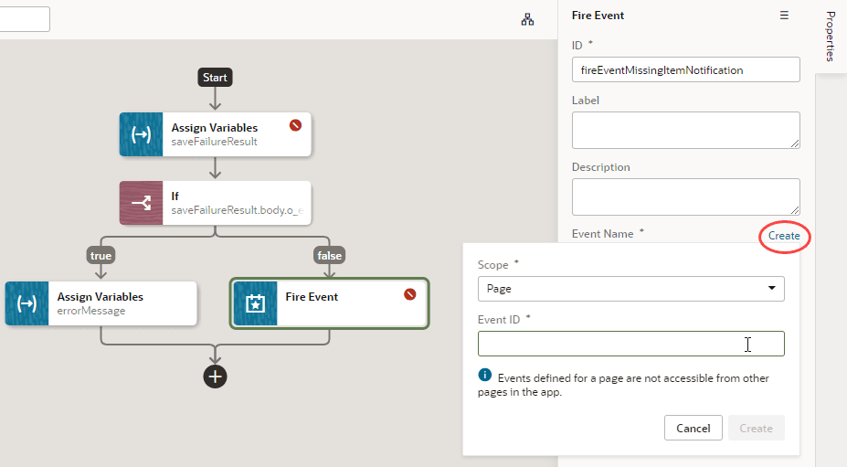

Start an Action Chain By Firing a Custom Event
You can start an action from another action chain using a custom event, which is triggered by the Fire Event action in an action chain. Typically, you use a custom event when you want to trigger a notification, like displaying a pop-up window with a message, or perhaps to transform some data. After creating a custom event, you need to create an event listener for it to start the action chain.
Each custom event has a Behavior property, which you can use to set whether action chains run serially or in parallel. The default behavior is “Notify”, which allows the action chains to run in parallel. For more about setting an event’s Behavior property, see Choose How Custom Events Call Event Listeners.
To start an action chain with a custom event:
  1. Open the Actions tab for a page, flow, or App UI.
  2. Select the action chain you want to edit. The action chain opens in the Action Chain editor. If you want to create a new action chain, click + Action Chain.
  3. In the Action chain editor, drag the Fire Event action from the palette and drop it in the action chain where you want the event to occur.
  4. In the Fire Event action’s Properties pane, specify the Event Name.
    If you are using the Fire Event action to trigger a new custom event, click Create, enter an Event ID, and specify the event’s scope. If you want to trigger a custom event that already exists, you can select it in the drop-down list.
    Description of fire-event.png follows
    After creating or selecting the event, you can click Go to Custom Event in the Properties pane if you want to edit the event’s Behavior or Payload properties in the Events editor.
  5. Create an event listener for your event:
    1. Open the Event Listeners tab and click + Event Listener to open the Create Event Listener wizard.
    2. Select the custom event you added to your action chain. Click Next.
    3. Select the action chain you want the event to trigger. Click Finish.
    Tip: If you’re on the Events tab, simply right-click your custom event and click Create Event Listener to create an event listener, called (eventId) Listener, in the same scope as the event.

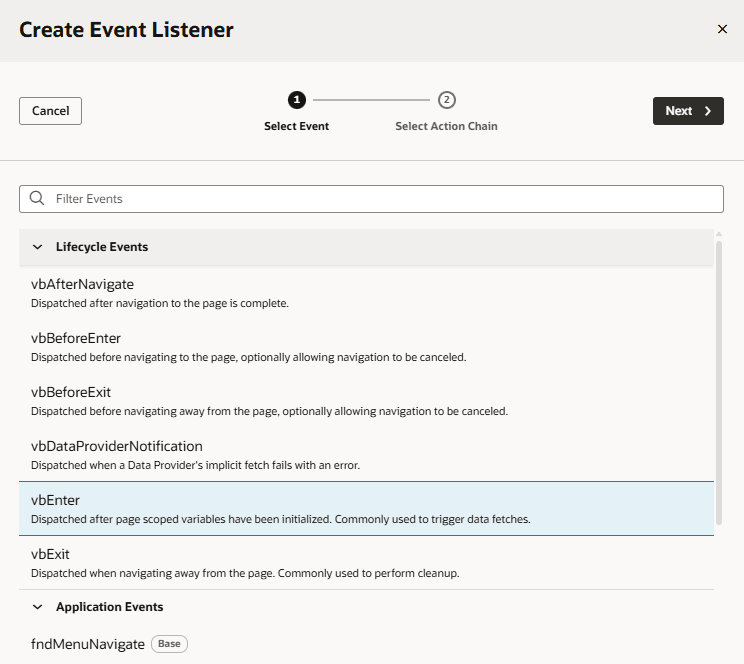

To start an action from a lifecycle event:
  1. Open the Event Listeners tab for the page containing the event you want to trigger an action chain for.
  2. Click + Event Listener.
  3. In the Create Event Listener wizard, expand the Lifecycle Events category and select the event you want to trigger an action chain for. Click Next.
    Description of page-designer-events-select-appui.png follows
  4. Select the action chain you want to trigger. You can select any action chain that is scoped for the artifact. For example, if you are creating an event for a flow artifact, you can only call action chains defined in the flow or in the App UI.
    If you want to create a new action chain now, you can click Add Action Chain icon and enter an ID for the new action chain, which you can edit later in the editor. Click Finish.
    Description of page-designer-settings-selectaction-appui.png follows
    Description of the illustration page-designer-settings-selectaction-appui.png
After you create an event listener, you can click Add Action Chain for the lifecycle event if you want it to start additional action chains.
