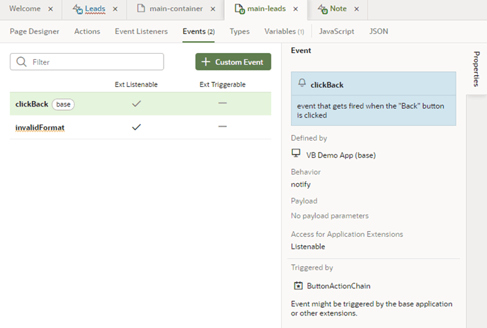

A dependency might define events that you can use in your extension to start action chains. In the Events tab of your page or Layout, you can see which events are Triggerable and/or Listenable by your extension. When you select an event in the Events tab, you can see details about the event in the Properties pane, such as the where it is defined, what triggers the event and the event's behavior type.
In this image you can see that the event defined in the base app (clickBack) is badge with
, and that it's designated as listenable by the app extension, meaning you could add an event listener to your app extension that listens for the clickBack event. You can't change the designation of custom events defined in the base app, but you can use them to start action chains defined in the base app or in your app extension.
