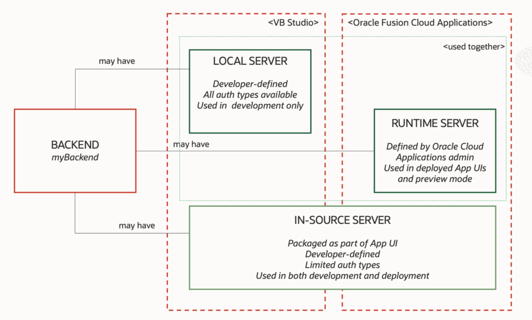

- An in-source server definition provides a backend’s details for use during both development and deployment. Its details live in an extension's source code (specifically in the
catalog.jsonfile) and is therefore packaged up as part of the extension itself. This means that the backend always points to the same URL and authentication method, irrespective of where you deploy the extension. - A local server definition provides a backend’s details for use during development only. Because its details aren't stored in an extension's source code, you can go beyond the limitations of an in-source server by defining the URL and authentication method for the particular instance you're deploying to. Typically, a local server is used in conjunction with a runtime configuration, specified in the Oracle Cloud Applications instance, which provides the backend’s details for the deployed extension (see Provide a Backend's Runtime Server Details). You can also use a local server with an in-source server to override its details during development, although this is far less common.
In VB Studio, a local server’s details are used by the Page Designer's Live view, while the server details provided by the runtime configuration and in-source server are used by the Preview action.
For example, suppose that during the development phase you want to use a mock URL. While testing you want to use a different URL, located in the test instance, and when you finally deploy you want to use the actual URL. You can achieve this using local servers, but not with in-source servers. The caveat is that local servers must be supplemented with a runtime configuration on the Oracle Cloud Application instance you are deploying to. The relationship between potential servers is shown here:

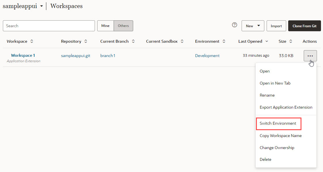

If your App UI needs access to a particular Oracle Cloud Applications instance—say, one that’s running a different version of Human Capital Management—use your project’s Environment's tab to add that instance to your Oracle Cloud Applications environment, then use Switch Environment to point your workspace to that environment (or just create a new workspace):
