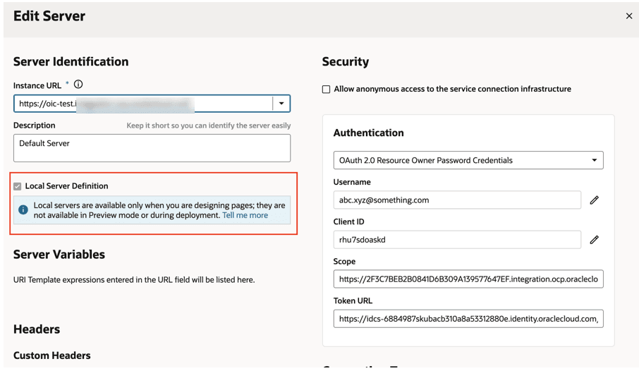

You'll also see that the Local server definition check box has been checked if you click the Edit Server icon: Description of servcon-lsdcheckbox.png follows

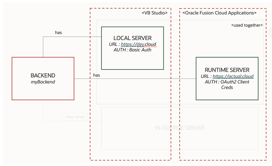

This diagram shows how a local server in VB Studio works in tandem with the runtime server configuration on an Oracle Cloud Applications:Description of servcon-localserv-oac1.png follows
In this image, myBackend has a local server. Within VB Studio, then, myBackend resolves to the URL https://devcloud with Basic Auth credentials. But when the App UI is served from Oracle Cloud Applications, either through the Preview action or after it is deployed, myBackend will resolve to https://actual cloud and OAuth 2.0 Client credentials.
