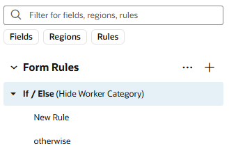

  3. Enter a label, id, and description for the rule. Click Create.
    An If/Else rule containing two child rules is created by default. The default names for the two child rules are "New Rule" and "otherwise", but you can rename them to something more meaningful. You can add as many child rules as you want, but remember that only one of them will be applied.
  4. Select New Rule.
    The first child rule is the first "If" part of the "If/Else" nested rule. In If/Else nested rules, rules are evaluated from the top to the bottom. New Rule is the first rule in the list, so it's the first to be evaluated.
