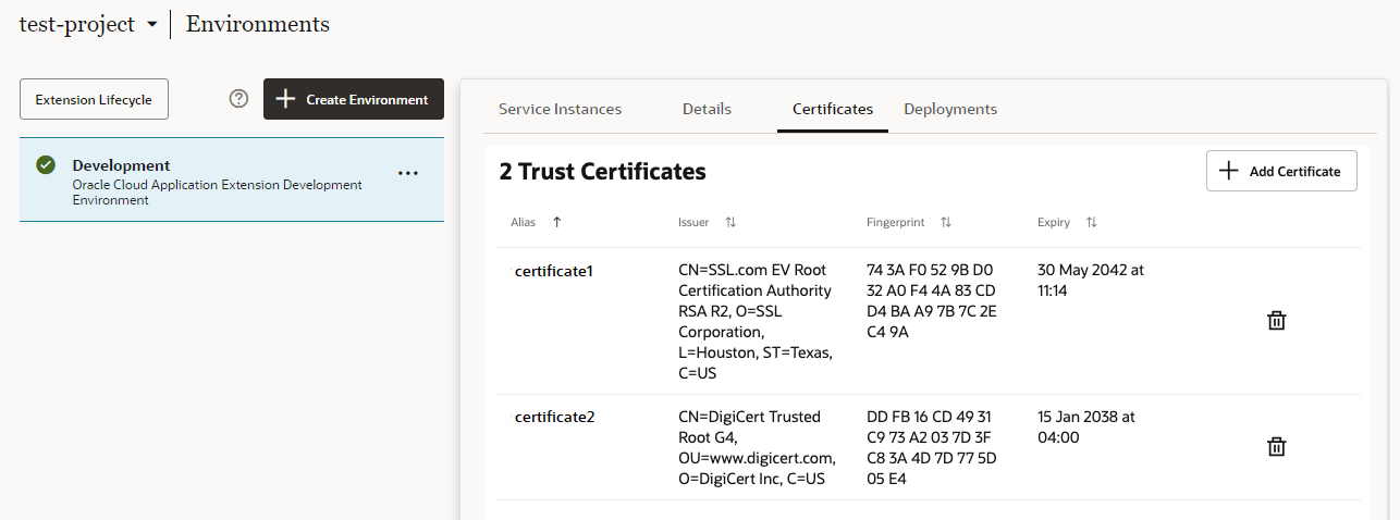

    The Certificates page displays a list of the trust certificates that have already been uploaded for the environment, similar to this:

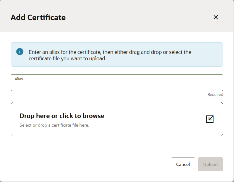

  3. Click + Add Certificate to open the Add Certificate dialog.
    You use the Add Certificate dialog shown here to create an alias for the certificate and upload the service’s certificate file from your local system:
  4. Type the alias in the Alias field.
    The alias is used to identify the certificate in the table on the Certificates page.
  5. Drag the certificate file from your local system to the upload target area, or click the upload target area to browse your local system to locate, select, and add the file.
  6. Click Upload to add the certificate to the environment’s truststore.
