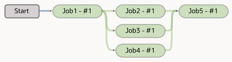

Let's look at an example, using this pipeline, MyPipeline.
Description of mypipeline.png follows
The log for Job5, which executed after the last build of the three parallel jobs (Job2, Job3, and Job4) finished running, shows that Job3 of the three parallel jobs was built last and triggered the build for Job5, the last job in the pipeline.
[2023-08-23 19:20:40] Build scheduled. Build started by pipeline MyPipeline [Upstream Jobs: Job2 Build: #1, Job3 Build: #1*, Job4 Build: #1]

The first line in bold indicates that the pipeline run was started by the pipeline (MyPipeline), a trio of jobs were built in parallel, and the build of Job3 finished after the other two, so it has the asterisk next to it, indicating that it was the trigger for starting the build of Job5. The other bold line, the Started By Upstream line, shows the same information. This information comes from a shell script that was added to a Unix Shell build step in Job5. You can see in the log where the script was run.
Only the direct upstream builds are listed, as they are the direct conditions to start the job whose log is being examined. For example, for the pipeline with Job1 followed by Job2 followed by Job3, the log for Job3 will list only Job2, which triggers the build of Job3. If all the pipeline jobs build consecutively, not in parallel, when you examine the Started by line in the log for the current build, you'll see just one build listed, with an asterisk next to it, indicating that it was the build that triggered the current build.
