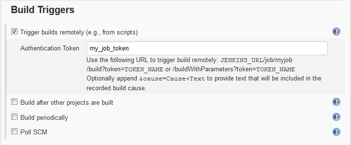

  4. Click the Build Triggers tab.
  5. Select the Trigger builds remotely (e.g., from scripts) check box.
    Description of the illustration jenkins-build-trigger-authentication-token.png
  6. In Authentication Token, enter a unique string as a token. You can enter any string value. Example: my_auth_token
    Make sure that the authentication token isn’t used in any other job.
