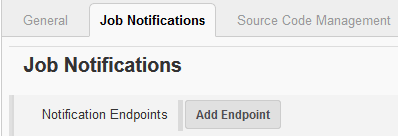

  5. In Notification Endpoints, click Add Endpoint.

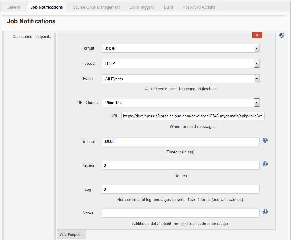

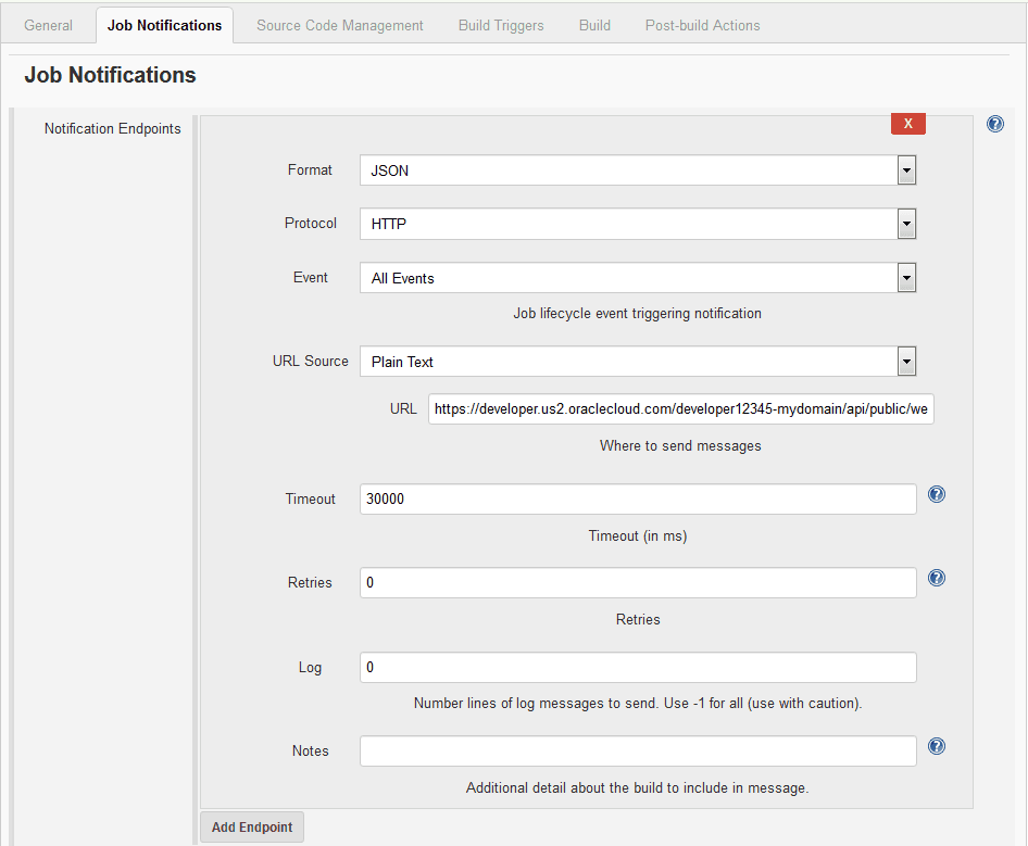

  6. In the URL field, paste the URL that you copied from the VB Studio webhook. Leave the default values in the other fields.
