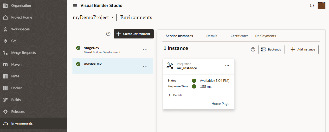

You can access and manage the project’s environments from the Environments page:
From the Environments page, you can:
Create and delete environments
Add or remove service instances from existing environments
Update the details of the environment
The Details tab displays details, such as name and description, for the selected environment. You can also instantly see the health of all service instances comprising each environment right on the Project Home page or on the Environments page.
View the details of an environment’s service instances
The Service Instance tab captures information, such as the health of and response times for service instances and their URLs, for each environment in a single place, so you won’t have to hunt for it later.
Upload and remove an environment’s trust certificates
The Certificates tab shows trust certificates that you upload to connect with external services in an environment, allowing all applications that use that environment to communicate with those services.
View deployments
The Deployments tab shows deployments for visual apps, for the current project only. To view deployments for application extensions, use the Application Extensions toggle, then click the Extension Lifecycle link.
Manage the lifecycle of deployed extensions
Click the Extension Lifecycle button to centrally manage application extensions deployed across environments (and across projects). On the Manage Extension Lifecycle page, you can view deployed extensions, deploy a published extension to a new instance, delete extensions when no longer needed, and even add new environments.
Note that you won’t see the Extension Lifecycle button if you haven’t yet added an Oracle Cloud Applications instance to your environment.
