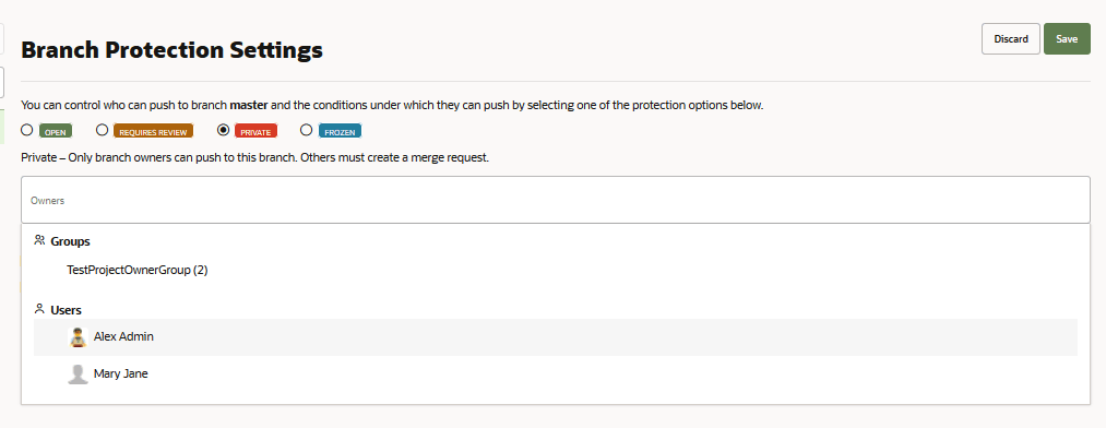

      Restrict push actions to project owners and branch owners Select the Private option, as shown: Description of branch-protection.png follows
      To define branch owners, click Owners and select the user(s) and/or group(s). You can select multiple users (or groups).
