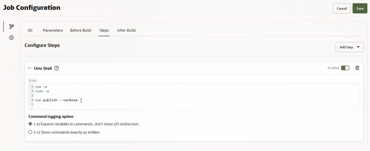

  4. In the Steps tab, add a Unix Shell step with a script, similar to this: npm-job-config-unix-shell-build-step.png
