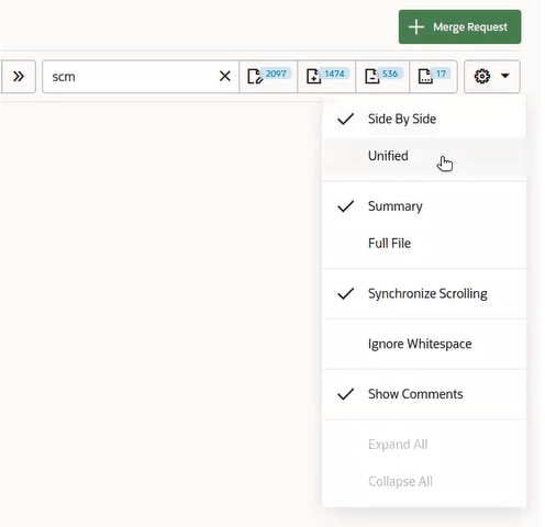

Tips for Working with Merge Requests that Have Large Numbers of Changed Files
If you’re working with merge requests that have a large number of changed files, you have several ways to narrow your view and focus in on just the files or commits that you are interested in examining:
On the upper left side of the Merge Request window, above the tree view, VB Studio prominently displays the number of changed files shown in the tree and, if the number is very large, the number of files that aren’t shown in the tree.
The maximum number of files that can be displayed is 4,000.
You can use the directional arrows to traverse the tree. Use the
or
left arrows to ascend the tree and the right arrows
or
to descend it.
You can enter a search term (perhaps a file type, such as .css or .js) in the Filter field, to limit your view to a particular file type.
You can use the quick filter buttons on the upper right side of the screen to focus in on the files that you want to examine. At the touch of a button, you can:
Show modified files
Show new files
Show removed files
Show renamed files
From the Settings
menu, you can select a single option or multiple ones that adjust what you see in the tree.
You can also expand all or collapse all files in the tree with one click.
