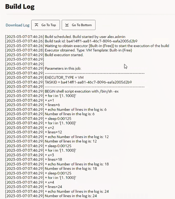

From the job’s details page, click Build Log
to open the build log.The log file opens and displays the lines (up to 100,000) as it lazy loads.
Scroll down to examine the log or use the floating menu at the top.

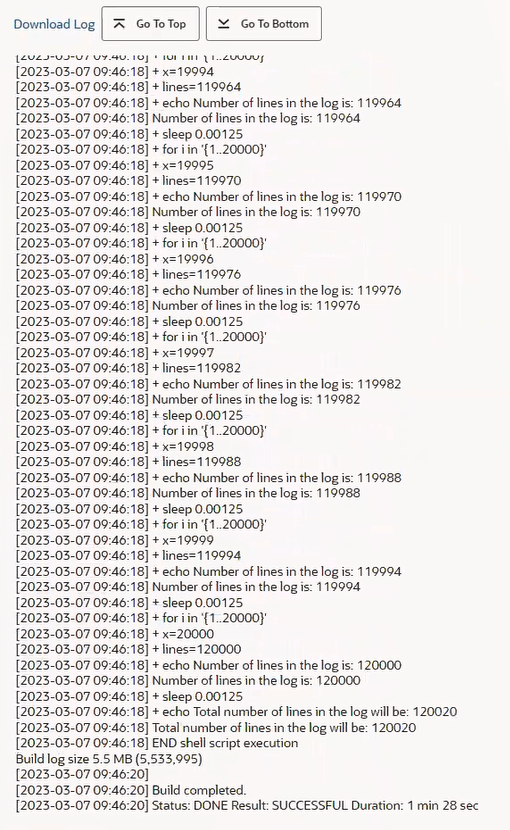

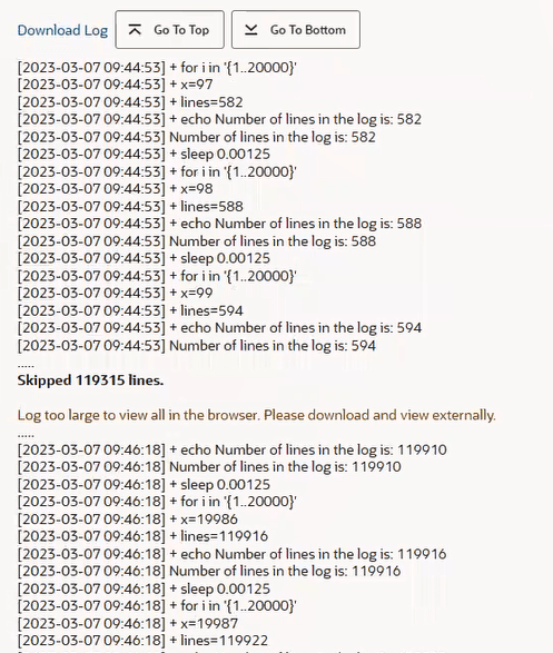

If your log file exceeds 100,000 lines, scroll up from the end of the log and you’ll see a message indicating how many lines were skipped.
Click the Download Log link and download the log file to your computer where you can open it in your text editor and scroll through the lines that were skipped in the log.
Click the Go To Top
button to return to the beginning of the log and examine the settings and parameters that were used in the build.
The log lazy loads as you scroll. You can see as much as you want to and can scroll down to about 100,000 lines. If you scroll that far, you’ll see the skipped lines notice plus the last 100 lines. If you click the Go To Bottom
button, all those lines will be loaded, the skipped lines notice will be displayed, and then the last 100 lines will be shown.
Clicking the Go To Top
button at that point will not change what is loaded. You’ll still see the first 100,000 lines plus the last 100.
