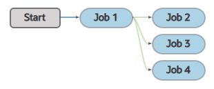

In this diagram, Job 2, Job 3, and Job 4 depend on Job 1 and run after Job 1 is successful. Job 2, Job 3, and Job 4 are scheduled in parallel. They can all run at the same time.

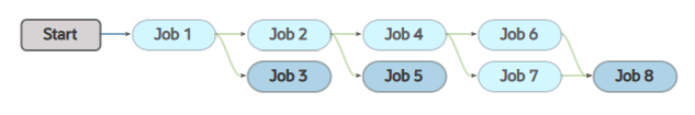

This diagram shows a complex example.
The above diagram defines these dependencies:
Job 2 and Job 3 depend on Job 1 and run after Job 1 is successful
Job 4 and Job 5 depend on Job 2 and run after Job 2 is successful
Job 6 and Job 7 depend on Job 4 and run after Job 4 is successful
Job 8 depends on Job 6 and Job 7 and runs after Job 6 and Job 7 are successful
Job 1 is the initial job. Running it triggers a chain. All jobs after it in the chain (Job 2 through Job 8) run automatically, one after the other.

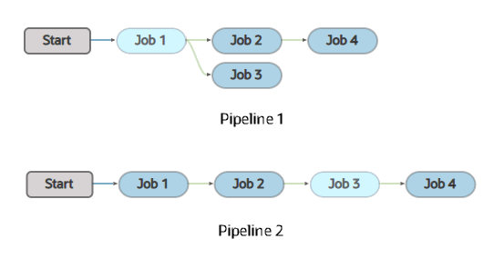

You can create multiple pipeline diagrams of jobs. If multiple pipelines have some common jobs, then multiple builds run some of those jobs. For example, in this figure, Pipeline 1 and Pipeline 2 have common jobs:
Let’s assume that Pipeline 1 is defined first and Pipeline 2 is defined second. If both pipelines are triggered, the builds run in this order:
A build of Job 1 runs.
Builds of Job 2 and Job 3 of Pipeline 1 get in the build executor queue after Job 1 is successful. A build of Job 2 of Pipeline 2 also gets in the build executor queue after Job 1 is successful.
Builds of jobs in build executor queue run on first-come first-served basis. So, Job 2 and Job 3 of Pipeline 1 run first. Let’s call the build as Build 1 of Job 2 and Job 3. Then, another build of Job 2 of Pipeline 2 runs. Let’s call it Build 2 of Job 2.
A build of Job 4 of Pipeline 1 joins the build executor queue as soon as Job 2 is successful. A build of Job 3 of Pipeline 2 also joins the queue when Job 2 is successful.
As soon as the build executor is available, Build 1 of Job 4 runs and Build 2 of Job 3 also runs. Remember that Build 1 of Job 3 ran in Pipeline 1.
After a build of Job 3 of Pipeline 2 is successful, a build of Job 4 of Pipeline 2 joins the queue and runs when the build executor is available. Remember that this is Build 2 of Job 4 as Build 1 ran in Pipeline 1.
While creating multiple pipeline diagrams with common jobs, be careful if a job is dependent on artifacts of the parent job.
