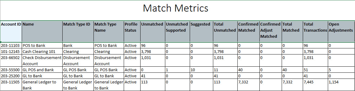

Match Metrics Report
| Output Columns | Descriptions |
Account ID |
The identifier associated with the reconciliation. |
Name |
The name of the reconciliation. |
Match Type ID |
The identifier associated with the match type. |
Match Type Name |
The name of the match type. |
| Profile Status |
The status of the profile (Active or Inactive) |
Unmatched |
The count of unmatched transactions. |
Unmatched Supported |
The count of supported transactions. |
| Suggested |
The total number of suggested matches, including suggested and suggested adjust. |
| Total Unmatched |
The total number of unmatched transactions |
| Confirmed Matched |
The number of confirmed matches |
| Confirmed Adjust Matched |
The number of confirmed adjusted matches |
| Total Matched |
The total number of matched transactions, including confirmed and confirmed adjust. |
| Total Transactions |
The total number of transactions |
Open Adjustments |
The count of open adjustments. |
