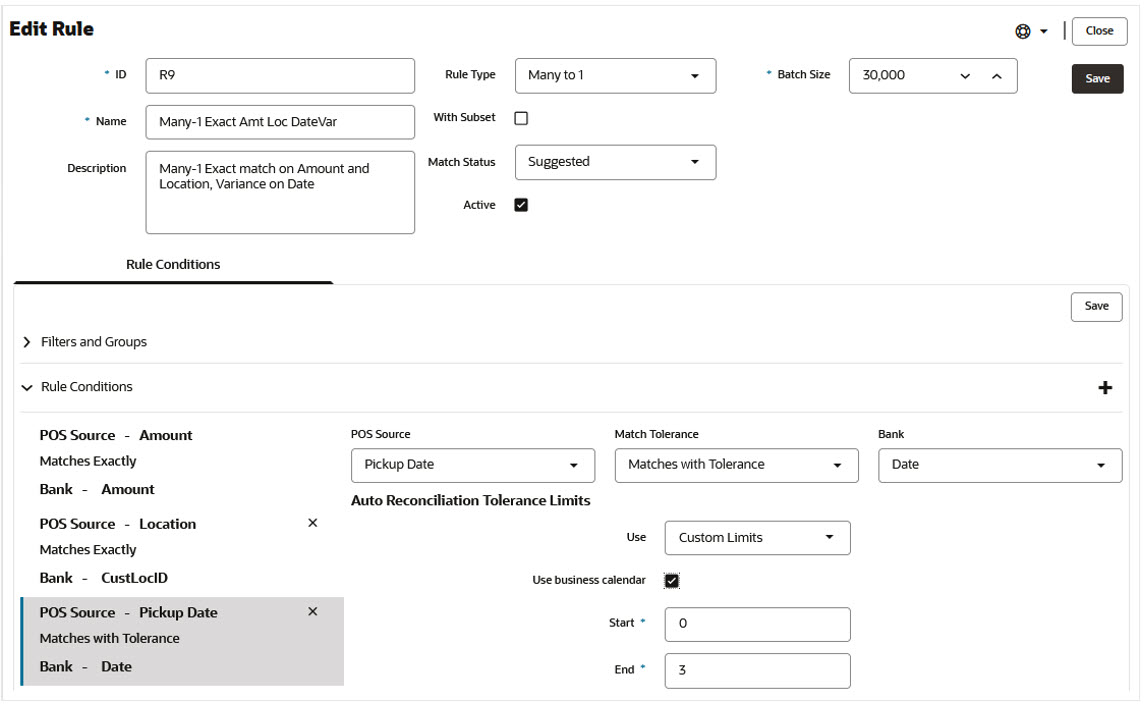

  • Business Calendar instead of a regular calendar in order to eliminate holidays and weekends for consideration in matching.
    By default, Account Reconciliation uses a regular calendar to specify the dates in a date range. You also have the option of using a business calendar when calculating date range in order to easily eliminate counting days that are work holidays for a company or weekends in calculation of the range. The Use Business Calendar check box is available as an option when creating Date Type attribute rule conditions with tolerance and also for match process default attribute mapping. The business calendar option is not available for manual matching.
    To use a business calendar, you must specify the work days for your organizational unit as well as a holiday rule containing the list of holidays. The organizational units are assigned to profiles and the associated business calendar is then used during creation of reconciliations. See Defining Organizational Units in the Setting Up and Configuring Account Reconciliation guide.
Here is an example of a rule that has date tolerance specified as well as showing the business calendar check box.
Example of date tolerance values and business calendar checkbox
For more details on creating rules with date tolerance when defining a match process, see Defining the Match Process by Creating Rules
