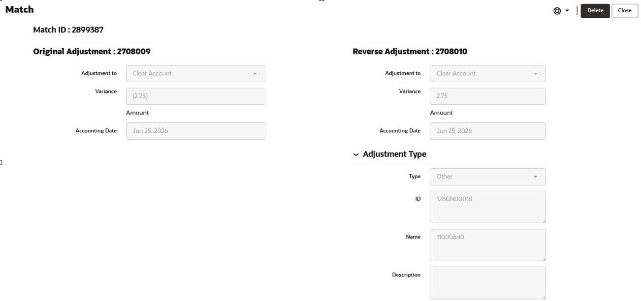

The Transactions tab shows the confirmed match, with Match ID 2899387 and Transaction ID 2708009. After an unmatch operation created a reverse adjustment for Transaction ID 2708009, the Transaction ID of the reverse adjustment is 2708010, but it's match ID is the same as the original adjustment.
Transactions tab showing a reverse adjustment that was created after Unmatch
Viewing Reverse Adjustment Details
To view details about a reverse adjustment, open its match details from the Matches tab or the Transactions tab in the Matching card. The details displayed, for the original adjustment and reverse adjustment, are shown below.
Match details for an adjustment and its reverse adjustment
