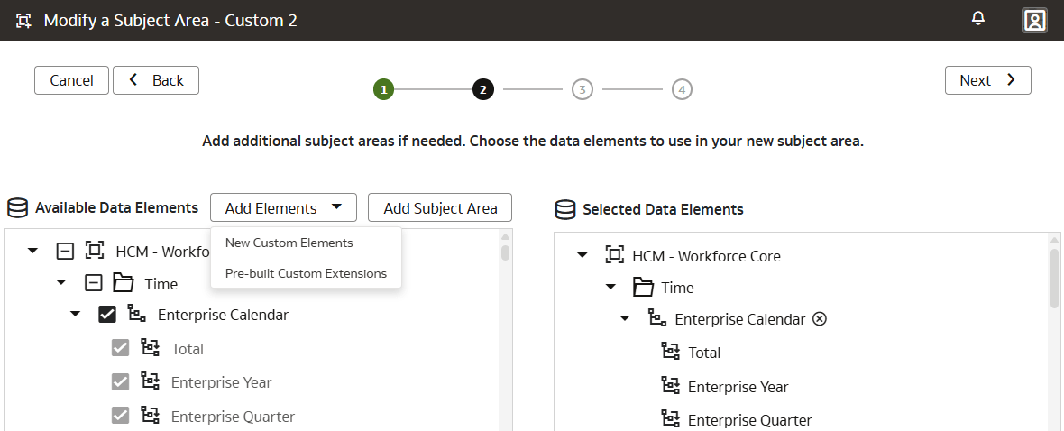

  8. In step 2 of the wizard,
    • If you're modifying a custom subject area, click Add Elements and then click New Custom Elements to select custom elements that you created.
    • If you're modifying a prebuilt subject area, click Add Elements and then click Pre-built Custom Extensions to select the prebuilt elements that you extended.
    Add Elements options
  9. Click Add Subject Area, select a subject area, and click Add to display the elements from the selected subject area under Available Data Elements. Select the elements to add them to the Selected Data Elements list.
