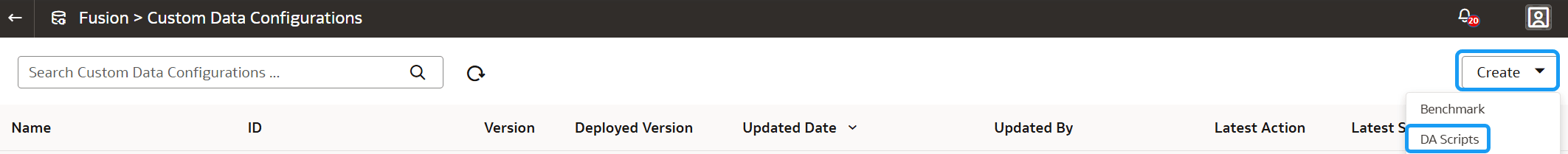

  3. On the Data Configuration page, under Configurations, click Custom Data Configurations.
  4. On the Custom Data Configurations page, click Create, and then select DA Scripts.

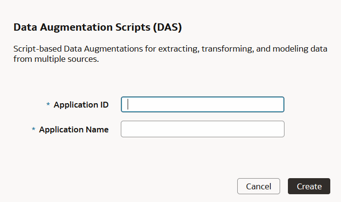

  5. In the Data Augmentation Scripts (DAS) dialog, enter an ID in Application ID, name in Application Name, and then click Create.

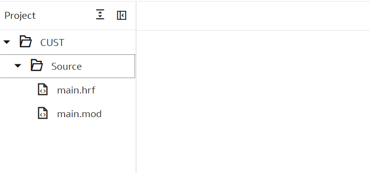

  6. On the DA Scripts page, in the left menu, click Source.

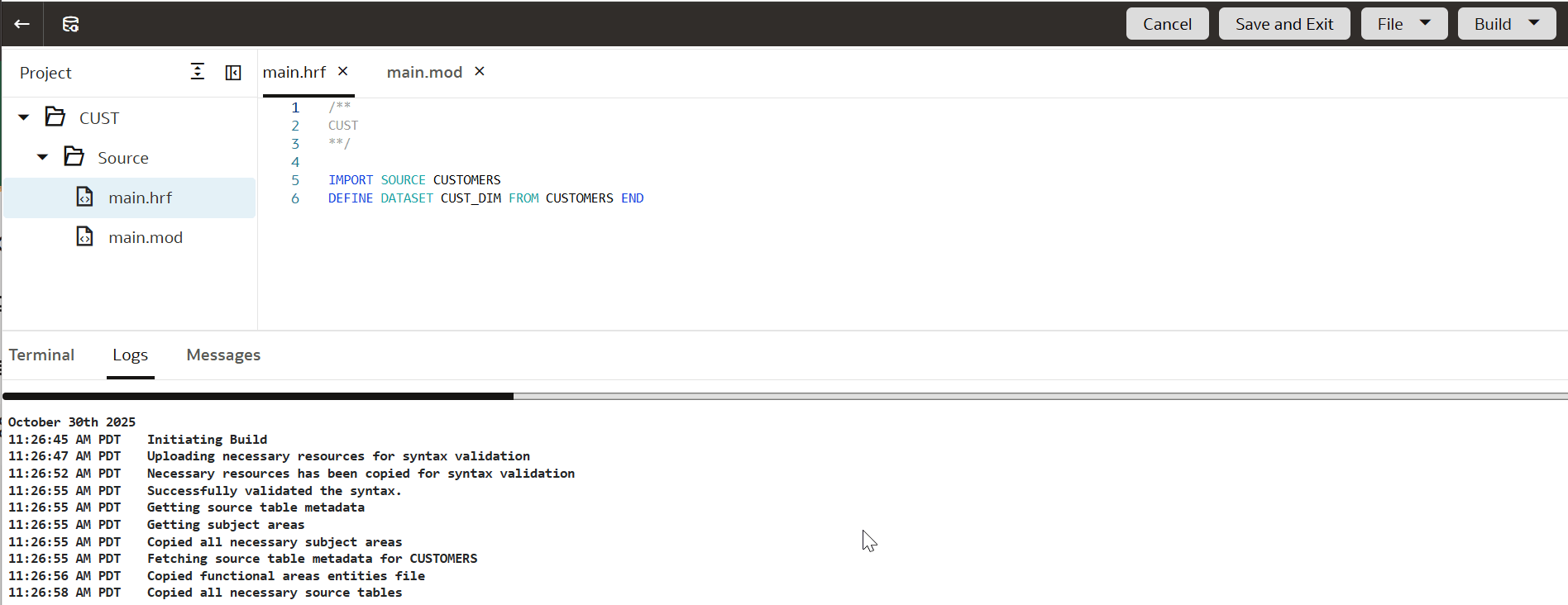

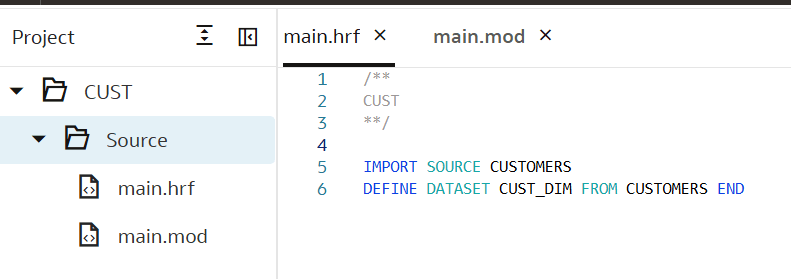

  7. Under Source, select main.hrf, and in the editor, enter the logic to bring data.
    In the following example, you create a data augmentation script for CUST_D using the sample Data Augmentation Scripts source files.
    To build your dataset, you can reference data from your sources into the data warehouse using the IMPORT command.

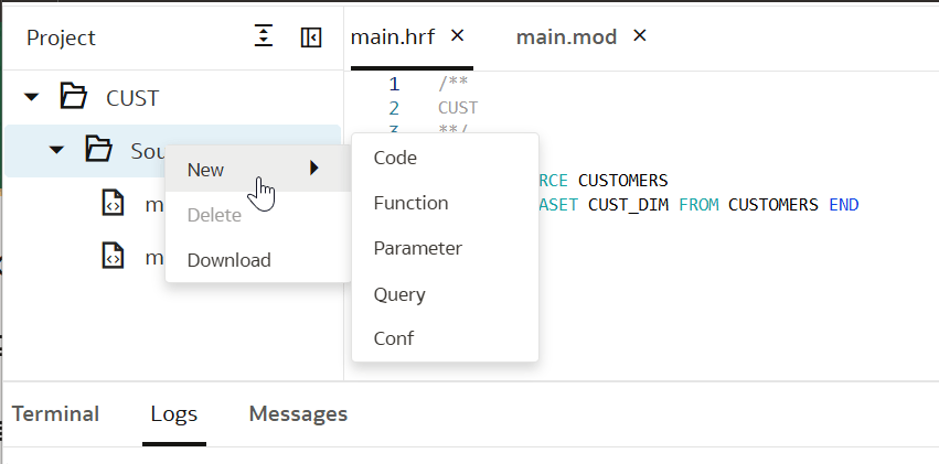

  8. Right-click the Source folder, select New and then select the type of file you want to create.

  10. Click Build and then select Build project.
    The project compiles and validates your syntax and to ensure that the source metadata are mapped properly.
