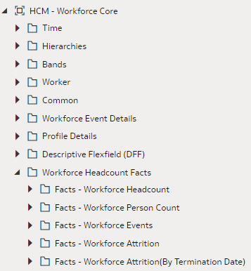

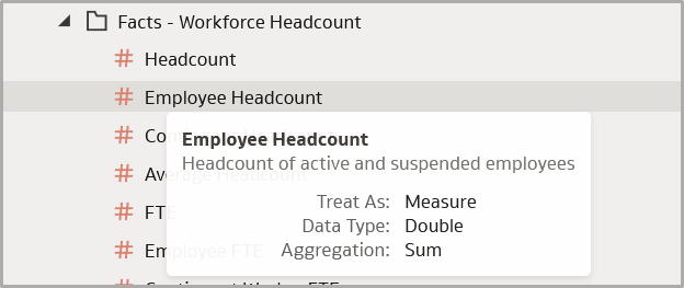

  • Use the prebuilt fact metrics whenever possible under the subject area you're using for your report. For each subject area, select the closest or most appropriate prebuilt metric for your reports, and then apply filters as needed.
    Hover over the metric name to see a description of the metric to use for your workbook. For example, to get a headcount of employees use the Employee Headcount metric.
    See Prebuilt in this guide for details.

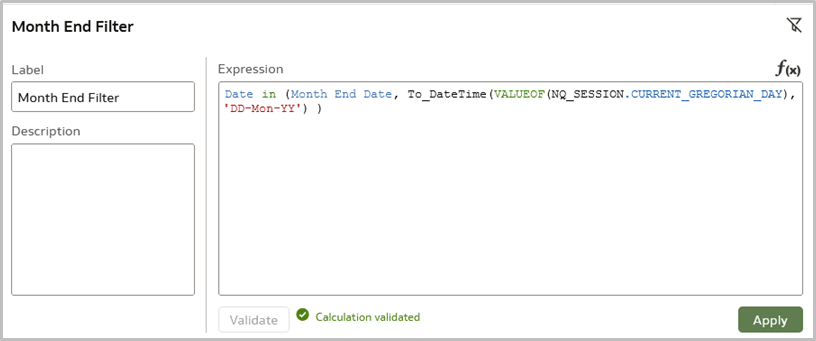

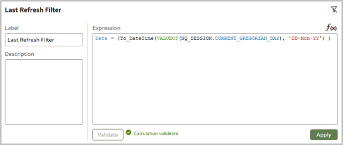

Tips for Improving Performance of Reports on Headcounts
When creating a report using the Headcount metric, the returned value is the last day of the selected period, or if you do a daily refresh, is the most recent snapshot refresh date. If you use the Headcount metric without a filter, you will only see the most recent snapshot. Apply a date filter on the most recent refresh date to select only the most recent data.
Use the expression To_DateTime(VALUEOF(NQ_SESSION.CURRENT_GREGORIAN_DAY), 'DD-Mon-YY') to create the filter on the most recent date, which significantly reduces the query time and resources to return the data you want.
Description of lastrefreshfilter.png follows
You can use the same principle to select headcount by month. Since headcount by month is returned using the last day of the month, apply an explicit filter to use the last day of the month and the most recent snapshot date to improve performance.
Description of monthendfilter.png follows

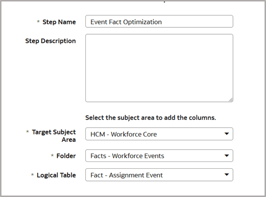

You'll need to use the semantic model extension to use this flag if it's not already available in the subject area.

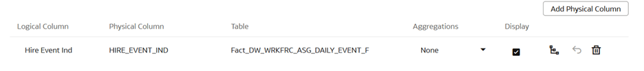

  1. Create a new step for Add Column.
  2. Add the HIRE_EVENT_IND physical column from the fact table and map it to a new logical column named Hire Event Ind. Be sure the new column is set to Display.
  3. Save and publish the new step.
    In the folder where you published the new step, you see the new Hire Event Ind column.

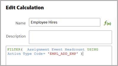

  4. In the Employee Hire column calculation in the workbook, replace the EMPL_ADD_EMP filter with a new calculation Hire Event IND = 1, and name it New Employee Hires. Add the filter on Assignment Type Code to select employees only..
