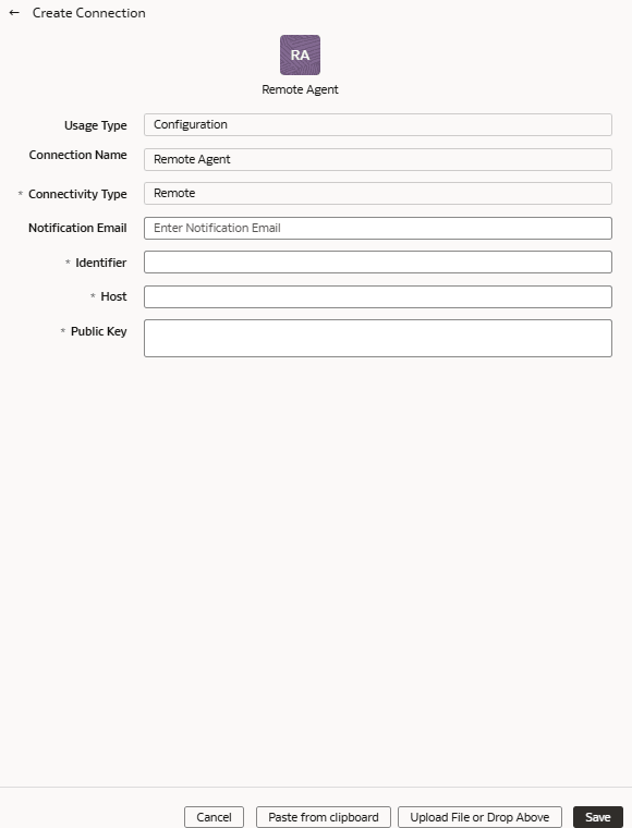

  5. In the Create Connection Remote Agent dialog, in Connection Name, you can modify the default name and verify that Remote is displayed in Connectivity Type.
    Create Connection dialog for the Remote Agent
  6. Populate the Create Connection page.
    1. Click and drag config.json into the dialog, or click Upload File or Drop Above and navigate to select config.json.
    2. To manually populate this page, open config.json, and enter the appropriate values for Identifier, Host, and Public Key.
    3. Click Save
    After configuring the remote agent on the Data Configuration page, wait for few minutes, refresh the remote agent page, and when you see the Agent Initialised message, you can proceed with other operations such as testing the connection to the remote agent, testing the connection to the remote source like EBusiness Suite, and refreshing the metadata. This enables you to run these jobs without timeout failures because data pipeline has a default timeout of 15 minutes.
