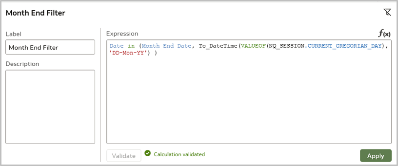

You can use the same principle to select headcount by month. Since headcount by month is returned using the last day of the month, apply an explicit filter to use the last day of the month and the most recent snapshot date to improve performance.
Description of monthendfilter.png follows

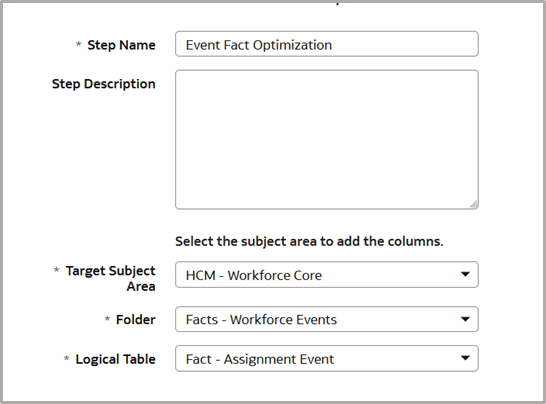

The Assignment Event fact table records all changes and events related to an employee's employment. Use the provided filters to get the results you want. For example, to see Employee Hires by Month, you can use the action type EMPL_ADD_EMP to select new employee hires.
In this example, you don't have any filters applied to the Assignment Event fact table. You can use the HIRE_EVENT_IND flag to identify hire events and optimize performance by filtering directly on the fact table.
You'll need to use the semantic model extension to use this flag if it's not already available in the subject area.
  1. Create a new step for Add Column.
  2. Add the HIRE_EVENT_IND physical column from the fact table and map it to a new logical column named Hire Event Ind. Be sure the new column is set to Display.
  3. Save and publish the new step.
    In the folder where you published the new step, you see the new Hire Event Ind column.
  4. In the Employee Hire column calculation in the workbook, replace the EMPL_ADD_EMP filter with a new calculation Hire Event IND = 1, and name it New Employee Hires. Add the filter on Assignment Type Code to select employees only..
