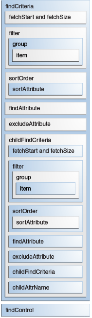

Request Payload Parameters
The parameters of the
                    find request payload give extensive
                control over the search criteria. This figure shows the parameters of the find operation.
This table lists the elements of the request payload and provides a brief description for each element.
