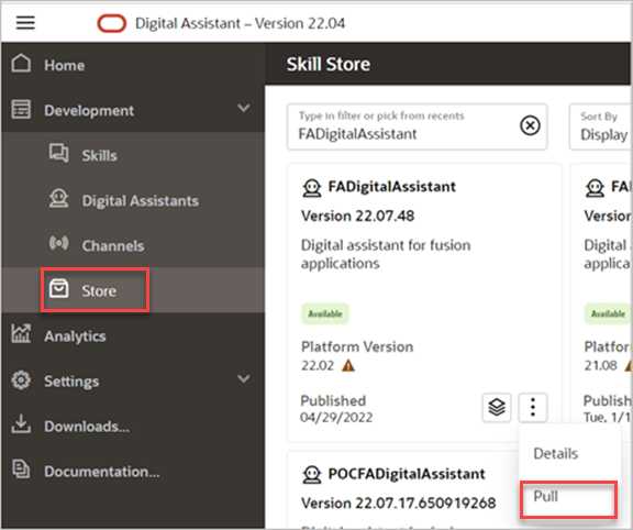

Here's the screen shot of a skill store from where you can pull FADigitalAssistant.
In Skill Store, search for the digital assistant or skill that corresponds to your application version, for example, FADigitalAssistant Version 22.07.48.
Note: The FADigitalAssistant tile shows the digital assistant version and the ODA platform version. The first four digits of the version number correspond to the application release and the last two digits show the FADigitalAssistant version within the release. For example, in the 22.07.48 version, 22 corresponds to the year 2022, and 07 corresponds to the quarterly release (01 = A, 04 = B, 07 = C, 10 = D) of the application version. The last two digits, 48, show the FADigitalAssistant version within the 22.07 release. The platform version is displayed in a four-digit format, the first two digits show the year, and the next two digits show the month. For example, in the 22.02 platform version, 22 corresponds to the year 2022, and 02 corresponds to February.- In the tile for FADigitalAssistant, click the menu icon and select
Pull.Note: FADigitalAssistant is pulled automatically from the skill store, but if the latest version isn’t pulled, you can manually pull it again.
