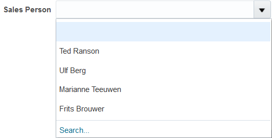

A dynamic choice list is a field that contains a list of values which are populated from the actual data of another object. At runtime, users can display the list of values, and then search for and make their selections. Let's look at an example.
Here's an example of a dynamic choice list field where users can add a salesperson to an opportunity. This is a custom field that's populated with records from the Resource object.
This is a screenshot of a dynamic choice list field at runtime, where users can search for and select a value for this field.
Notice that each dynamic choice list field includes the following:
  • A list of the most recently used records for greater efficiency.
  • A search link that, when clicked, opens the Search and Select dialog where users can search for and select a record. Again, this improves efficiency by making it easier to find the right selection.
