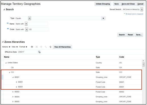

The geography level that you selected for grouping appears as an expandable Group Zone when the grouping is complete is shown in the following figure.
