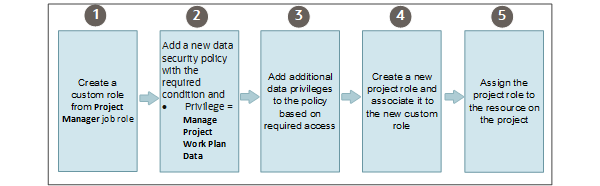

Application administrators can configure data security to grant project manager access to upcoming projects. In this example, let’s create a new role Senior Project Manager who will have access to active and upcoming projects.
To achieve this, the application administrators need to:-
Create a custom role from Project Manager job role:
- Log in as a project application administrator.
Select .
On the Roles tab of the Security Console, select the Project Manager role.
Copy the Project Manager role by selecting the Copy Top Role copy option.
Specify the role name as Senior Project Manager.
Add a new data security policy:
For the new role Senior Project Manager, go to the Data Security Policy page.
Click the Create Data Security Policy icon to create a new policy.
In the Create Data Security window add the new data security policy:
Field Value Policy Name <Name of your choice> Database Resource Project for Table PJF_PROJECT_ALL_VL Data Set Select by instance set Condition Name Access current and upcoming projects in the table PJF_PROJECTS_ALL_VL where user is authorized Actions Manage Project Work Plan Data
Add additional data privileges:
Add more data privileges to the policy created in step 2.
The following is a recommended list of actions you should select to get access to planning and budgeting activities in the Project Management work area:
Manage Project Work Plan Baseline Data
Assign Project Resource to Project Data
Manage Project Task Structure
Manage Project Budget
Manage Project Work Plan Resource Assignments Data
- Create a project role and assign it to the newly created enterprise role Senior
Project Manager.
- From Setup and Maintenance, navigate to set up UI Manage Project Roles.
- Create a new project role Senior Project Manager and assign the new
security role Senior Project Manager as Enterprise role.
- Log in as project administrator and assign a user this new role on an upcoming project with assignment start date as project start date.
Log in as Senior Project Manager to an upcoming project. Project Manager work area should show the upcoming projects.
