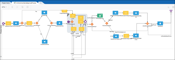

For this example, you're using a seeded template called ExtnBusinessProcess on an as is basis. You can edit this template to suit your business case.
For more information on this template, see the Object Workflows and Business Processes topic.
This figure shows the seeded template. -

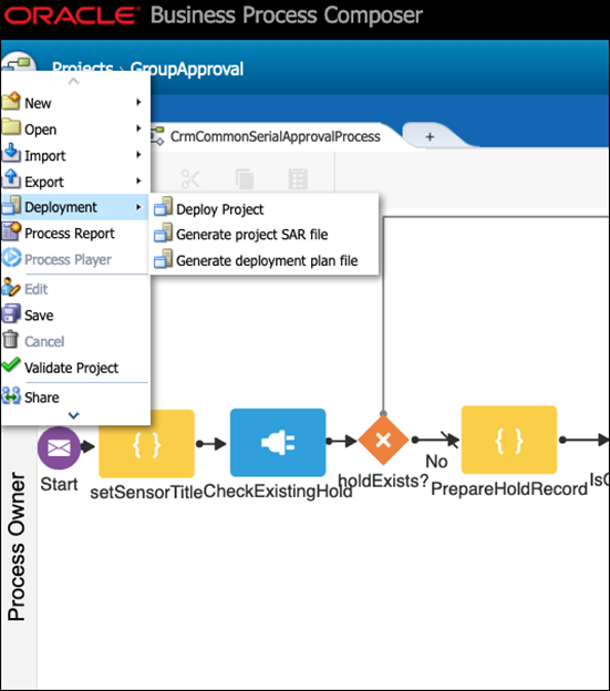

Click Deploy Project using the main menu.
This figure shows the main menu. The Deploy Project dialog box appears.
In the Deploy Project dialog box, enter the following information:
Field
Value
New Revision ID
Provide an identifiable ID.
Deployer Name
Your sign in name.
Password
Your password.
Mark composite revision as default
Select this option.
Version
Current project.
Click Deploy.
A confirmation message appears after your project has been deployed successfully.

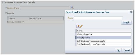

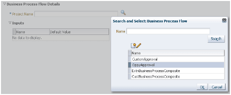

In the Actions region, select Business Process Flow. Create Action: Business Process Flow page opens.
Configure the event action as follows:
Enter Sales Lead Approval in the Name field.
In the Project Name field, search and select Sales Lead Approval project that you had created and deployed.
This figure shows how you search and select a deployed business process (approval flow). -
Click OK.
