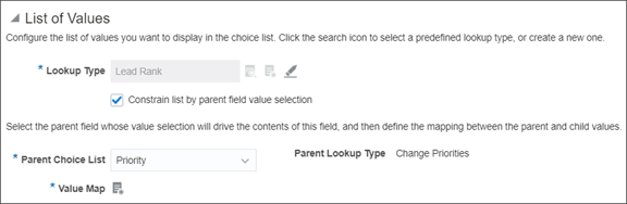

Mapping List Values to Parent Values
You can constrain the actual values that display in the fixed choice list at runtime by relating the fixed choice list to a parent fixed choice list. The value selected in the parent fixed choice list drives the values that display in this fixed choice list. This is usually referred to as a dependent fixed choice list, or dependent LOV.
For example, you might want your users to see two choice lists when creating a trouble ticket: one field for specifying the trouble ticket type and one field for specifying the trouble ticket area. If a user selects Hardware from the Type choice list, then the Area choice list should contain only hardware options that the trouble ticket can be logged against, such as Desktop or Laptop.
To do this, while creating the Area fixed choice list, select the Constrain List by Parent Field Value Selection check box, select the Type parent field, and then map the values between the parent lookup type and this field's lookup type.
To implement the previous example:
Define the Type fixed choice list.
Define the Area fixed choice list.
Select the Constrain List by Parent Field Value Selection check box and select the parent field, Type.
You can select the Constrain List by Parent Field Value Selection check box only during field creation, and only if at least one other single-select fixed choice list has been defined. After field creation, however, you can always update the mapping between lookup values.
Map the values between the Type and Area lookup types.
For example, map all relevant hardware values in the Area lookup type's set of values, such as Desktop and Laptop, to the value of Hardware in the Type's lookup type.
