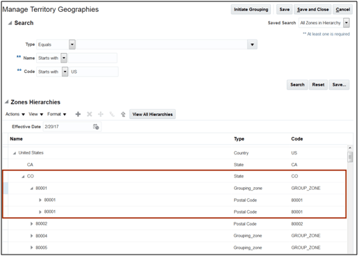

    The geography level that you selected for grouping appears as an expandable Group Zone when the grouping is complete is shown in the following figure.
    Manage Territory Geography page with the newly created group zones highlighted
