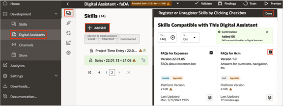

Here's the screenshot that shows how to add custom skills.
Search for the digital assistant you want to add the skills to.
Open the extended FADigitalAssistant and click Add Skill.
Note:Ensure that the Skills tab is selected.
In the extended FADigitalAssistant tile, click the check box to register the skill and then click Done.
