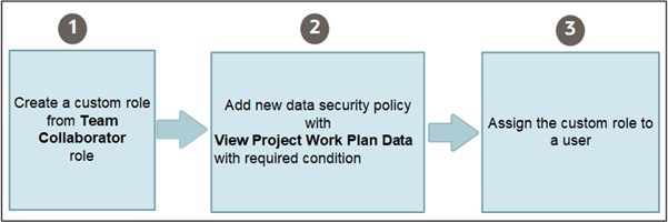

- Create a custom role from the Team Collaborator job role:
- Log in as a project application administrator.
Select .
- On the Roles tab of the Security Console, select the Team Collaborator role.
- Copy the Project Manager role by selecting the Copy Top Role option.
- Specify the role name as View-only non-team-member.
- Add a data security policy:
- For the new View-only non-team-member role, go to the Data Security Policy page.
Click the Create Data Security Policy icon to create a new policy.
In the Create Data Security window, add the new data security policy:
Field Value Policy Name <Name of your choice> Database Resource Project for Table PJF_PROJECT_ALL_VL Actions View Project Work Plan Data
- Assign the custom role to users:
You can select existing users in the Users page when creating the custom role.
You can also add the new role to any users from the Users tab of Security console.
