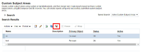

               Navigate to Application Composer.
               Click Custom Subject Areas on the Overview page of Application Composer.
               Select Create from the Actions menu.
Here are the steps in the train stops that you can use for configuring your custom subject area:

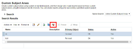

               On the Overview page of the Application Composer, click Custom Subject Areas.
               Locate the custom subject area that you want to edit, and click the Edit icon. You can filter out inactive custom subject areas in Application Composer by viewing custom subject areas in Active status. This is safer than deleting them, because the inactive subject areas are still available and can be found by searching.
               Make the desired changes and then click Submit to republish the custom subject area.
