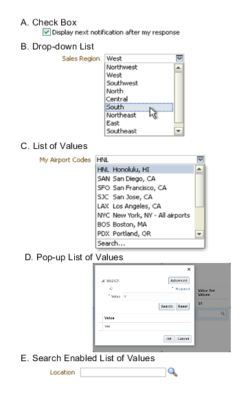

The series of figures (A to L) represent how the display types render on the UI. Each display type screenshot is assigned an alphabetic character that maps to the display type and its description in the table.

| A | Check Box | The field appears as a check box. If you select the check box, the checked value is used. Otherwise, the deselected value is used. |
| B | Drop-down List | The field appears as a list of values from which you can select. It supports a smaller number of values. |
| C | List of Values | The field appears as a list of values from which you can select. |
| D | Pop-up List of Values | The field appears as a list of values from which you can select. It supports large volumes of values. |
| E | Search Enabled List of Values | The field appears as a text field with a Search icon. You can type a value in the text field. You can also click the Search icon that opens another window for searching. |
