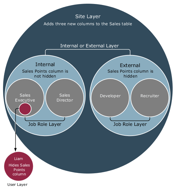

When a user opens an object or a page, the configurations at the highest layer applicable to an object or a page are given precedence. Let's say you added three columns to a table and then configured these columns for each context layer in this way:
               At the Site layer, you added three columns to the Sales table, namely, Promotion Name, Sales Points, and Partner Name.
               For the external developer, the Sales Points column is hidden.
               For the internal sales role, the Sales Points column isn't hidden.
Liam, who's an internal sales representative, personalizes this page for himself and hides the Sales Points column.
This is how different users see the column:
| User | Sees Sales Points Column? |
| Internal sales role | Yes |
| External developer | No |
| External recruiter | No |
| Liam | No |
Here's a visual representation of these configurations in different context layers and values.
