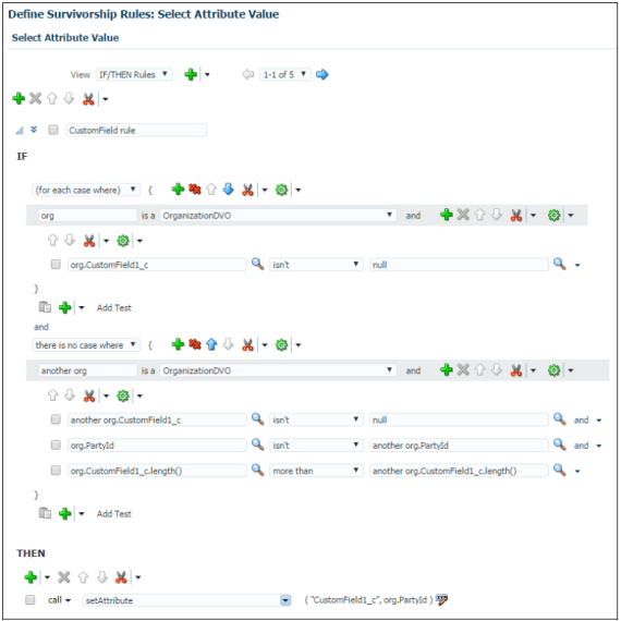

This topic explains how to define a survivorship rule of the type Set Attribute Value to select the smallest value for a specific attribute. This rule has a single condition where it picks a record that has the smallest value for the specified custom attribute.
The following table contains the details of a use case for a set attribute value rule to select the smallest value for a specific custom attribute as the survivor. In this case the example attribute name is CustomField1_c.

In this case, there are three records with CustomField1_c custom attribute. The value 123 is picked up as the survivor value for the CustomField1_c custom attribute because it's the smallest value for that attribute.
