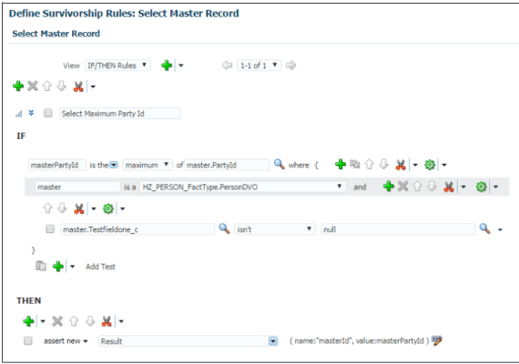

This topic explains how to define a survivorship rule of the type Set Master Record to select the party with a specific custom attribute as the master.
This rule identifies and returns the master record based on the following two conditions:
Pick master that has a specified custom attribute. In this case the custom attribute is Testfieldone_c.
Pick master that has the highest Party ID.
The following table provides the details of a use case for setting master record rule to select the party with a specific custom attribute as the master.

In this case, there are two records with the custom attribute Testfieldone_c. Therefore, the record with highest party ID is picked as the master record.
