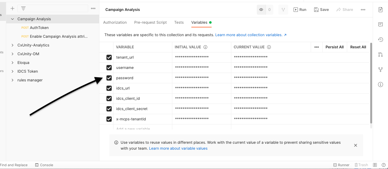

      • Download this collection and import it in Postman.
    • For the collection, go to the Variables section and change the details according to the respective tenant in the CURRENT VALUE attribute.

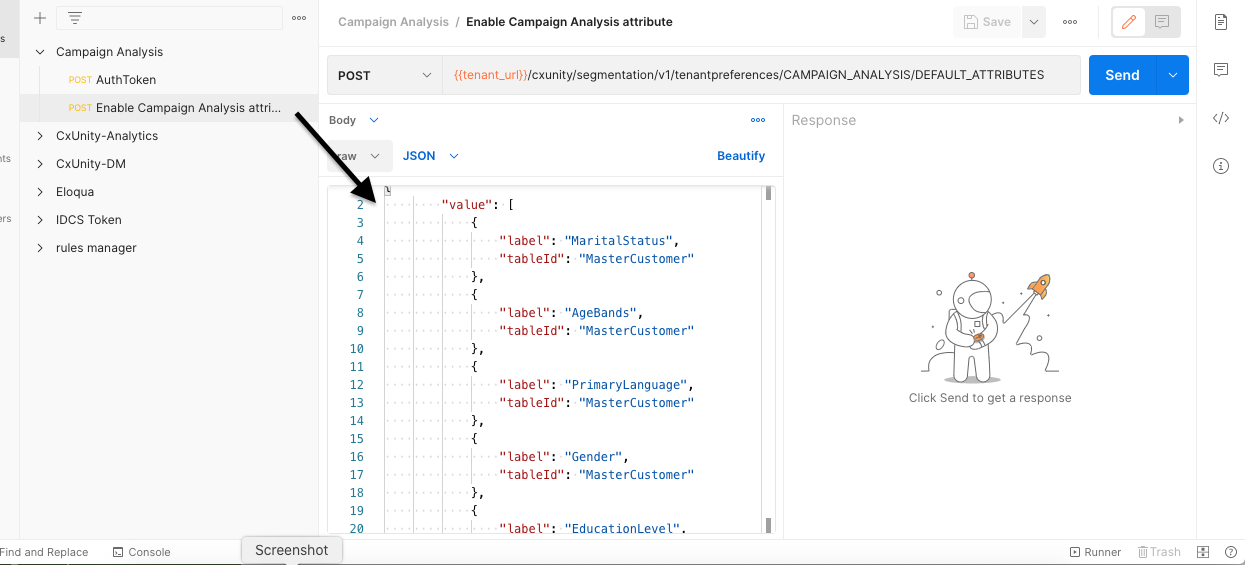

    • Once every thing is ready in postman collection, go to collection request Enable Campaign Analysis attribute and in the body section, add or update the attributes which you want as part of campaign analysis.
      Note: This is the list of dimension attributes you have created in step 5.
    • Select collection and click on the Run button to execute the API.
    • Once the API has run successfully, you will see the 200 and 201 responses.
