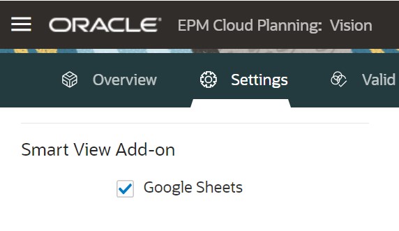

  3. In the Smart View Add-on section, select the Google Sheets check box. This check box is not selected by default.
    Google Sheets check box in Application Settings
  4. Click Save.
