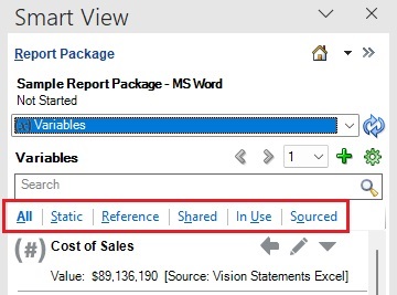

To filter variables:
  1. Open a report package, and then open a doclet.
    You do not need to check out a doclet in order to filter variables.
  2. In the drop-down list in the Report Package panel, select Variables.
    Shows the options available in drop-down list in the Report Package. Options are Report Center and Variables.
    The list of variables available in the report package is displayed in the panel.

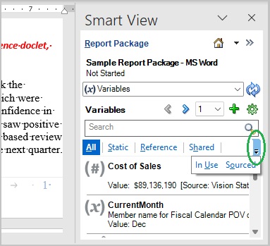

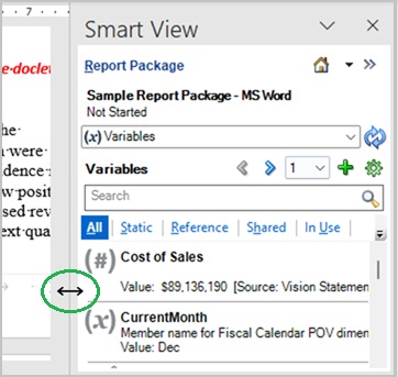

  3. Choose a filtering option by clicking the links at the top of the variable list:
    A portion of the panel showing the variable filtering options, All, Static, Reference, and In Use.
    • All—Displays all variable types, static and reference.
    • Static—Displays only static variables.
    • Reference—Displays only reference variables
    • In Use—Displays only those variables that are in use in the currently-opened doclet.
