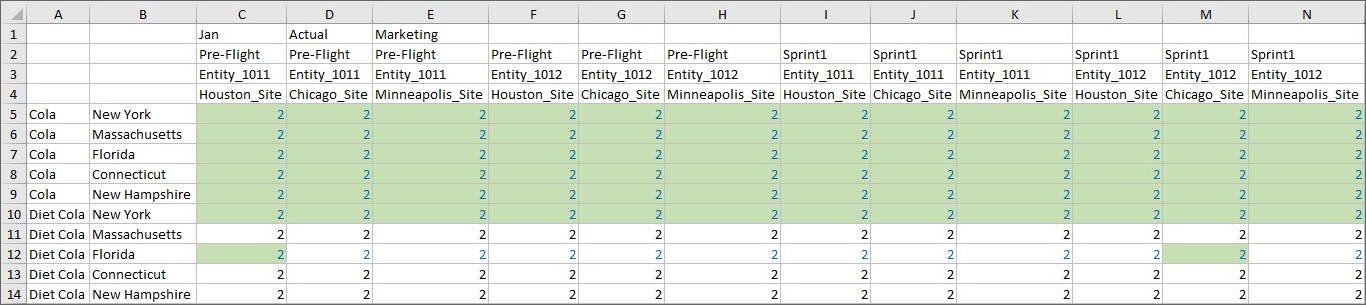

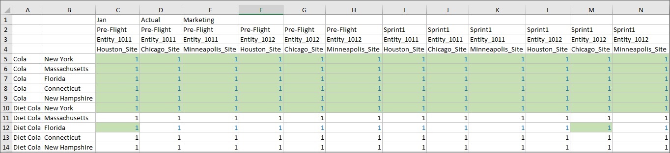

The asymmetric grid above is a slice of this symmetric grid, where the hierarchy members are uniform across rows and columns:
Figure 6-12 Starting Symmetric Grid - All Data Values = 1
A symmetric grid with uniform row and column members. All data values in the grid equal 1.
We’ll show the result of running three different types of calculations on the asymmetric grid, and then the effect those calculations have on the symmetric grid.
The scripts are configured to increment the data cells by 1 each time they are run, with different results on the symmetric grid for each type of calculation.

We submit the cells in the asymmetric grid, then go to the symmetric grid and refresh it. Note that on refresh, every Entity, Version, Scenario and Site for the Product/Market combination is calculated, even though they aren't on the asymmetric grid. This is because, by default, absent a tuple calculation,Essbase calculates the Cartesian product of the combinations seen in the grid. The result is that all cells in the POV are incremented by 1, so you will see a value of 2 in all data cells in the symmetric grid:

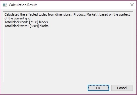

Second, we’ll run a more limited calculation on the asymmetric grid, shrinking the calculation scope to Product and Market grid tuples so that fewer intersections are calculated. The Calculation Result message shows us the scope of this calculation:
Figure 6-15 Calculation Result Dialog After Running Tuple Calculation on All Product and Market Tuples
The Calculation Results dialog after running the tuple calculation on all Product and Market tuples. The Total block read is 7168 blocks; the total block write is 3584 blocks.

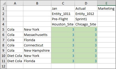

Refresh, and all data cells in the asymmetric grid are incremented to 3. Submit the data on the grid.
Figure 6-16 Asymmetric Grid After Running Calculation on All Product and Market Tuples
The asymmetric grid after running the calc for all Product and Market tuples. All data values in the grid equal 3.

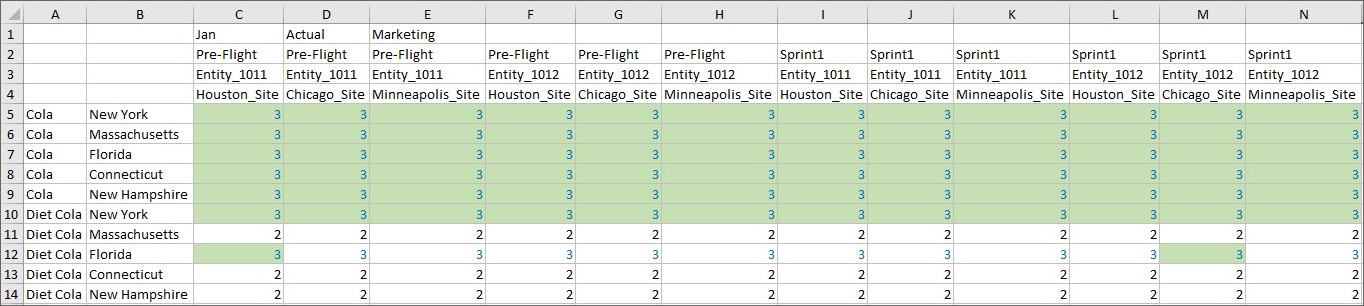

In the symmetric grid, note on refresh that only the Product/Market tuples already included on the asymmetric grid are calculated, along with all Site/Version/Entity combinations. These are all the columns of rows 5 through 10, and row 12. These cells now show a data value of 3. The Product/Market tuples not shown in our asymmetric grid are not calculated in the symmetric grid; their data cell value is still 2. For this calculation, only Product and Market combinations were specified for tuples. The tuples and all members for unspecified dimensions (those not specified in the FIX statement) are calculated.
Figure 6-17 Symmetric Grid After Running Calculation on All Product and Market Tuples on Asymmetric Grid and Refresh
The symmetric grid after running the calc for all Product and Market tuples and refreshing. All members related to the Product and Market tuples equal 3; the remaining member combinations equal 2.

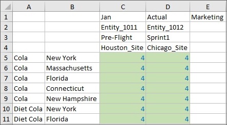

Values in all cells in the asymmetric grid are incremented to 4. Submit the data on this grid.
Figure 6-19 Asymmetric Grid After Running Calculation on Grid Product and Market Tuples
The asymmetric grid after running the calc for grid Product and Market tuples. All data values in the grid equal 4.

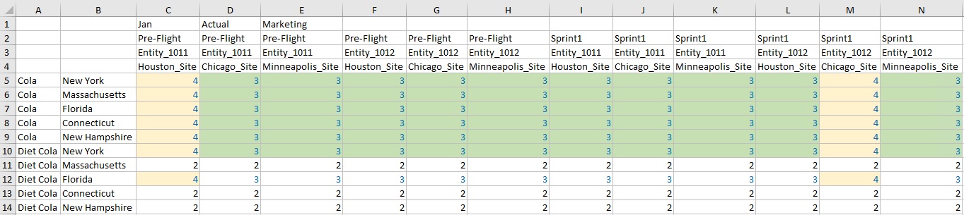

Move to the symmetric grid and refresh. Remember, the tuple calculation specified that only the Entity, Site, Market, Product, Version combinations indicated on our asymmetric grid should be calculated. On the symmetric grid, you can see that only rows 5 through 10 and row 12 and columns C and M, are incremented to 4. These are the tuples that correspond to the data that was incremented in the asymmetric grid, and are highlighted in yellow below:
Figure 6-20 Symmetric Grid After Running Calculation on Grid Product and Market Tuples on Asymmetric Grid and Refresh
The symmetric grid after running the calc for grid Product and Market tuples and refreshing. All members related to the grid Product and Market tuples equal 4; the remaining tuples combinations remain 3, and the remaining member combinations still remain at 2.
