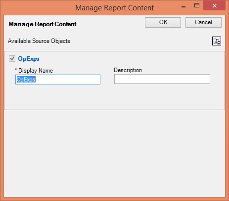

As a doclet author, you can add or delete existing report content (named ranges) or rename a named range in a reference file. For example, as a doclet author, you can delete report content that is no longer in use.

- In Properties , click the Embedded Content tab,
, and then click the Available Files link. - To change the display name and description of named ranges in the reference file:
- To delete a reference file:
