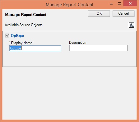

- To change the display name and description of named ranges in the reference file:
- To delete a reference file:
