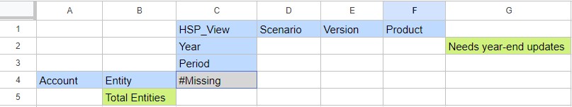

  1. Open an ad hoc grid containing comments, and click Refresh.
    In the example shown below, the grid displays some comments in the sheet.
    Figure 8-10 Grid Showing Cells Marked with Comment Style
    Grid showing comment cells

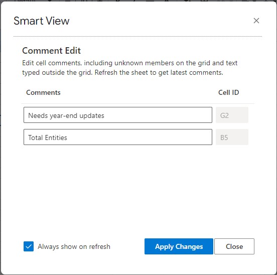

  3. Select Data, More, and then select View Comments.
    The Comment Edit dialog box is launched.
    Based on the grid in the above example, the Comment Edit dialog shows the comments present in the sheet which can be edited.
    Figure 8-11 Comment Edit Dialog
  4. To edit the text in a comment cell, in the Comment Edit dialog, click in the comment cell text box to edit; and then modify the text as required.
    Using the example Comment Edit dialog, click in the "Total Entities" comment cell text box, and then change "Total Entities" to "Total Entity".
  5. Click Apply Changes and note the change in the grid.

  7. To delete comments:
    1. Launch the Comment Edit dialog, click in the comment cell text box to highlight the editable text; and press the Delete key.
    2. Click Apply Changes in the Comment Edit dialog to return to the ad hoc grid sheet.
    3. Click Refresh.
