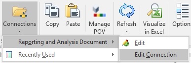

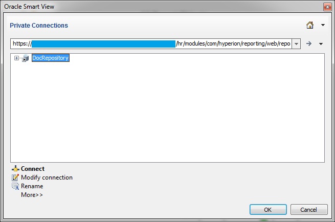

You can change connections for Financial Reporting fully-formatted reports or images within an Office document using the Private Connections dialog, which is accessed from the Connections button on the Smart View ribbon. This is useful when sharing an Office document between departments or when moving from a test to a production environment.
