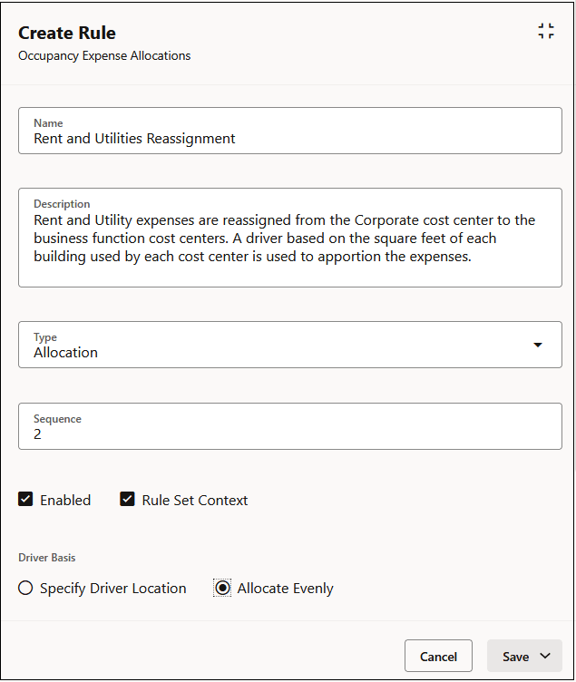

In the following example, the Rent and Utilites Reassignment rule is defined as an Allocation rule and will be the second rule run in the Occupancy Expense Allocations rule set. It will be enabled by default, use a previously-defined Rule Set Context, and the data will be allocated evenly across all destinations.
Definition for the Rent and Utilites Reassignment rule in the Occupancy Expense Allocations rule set

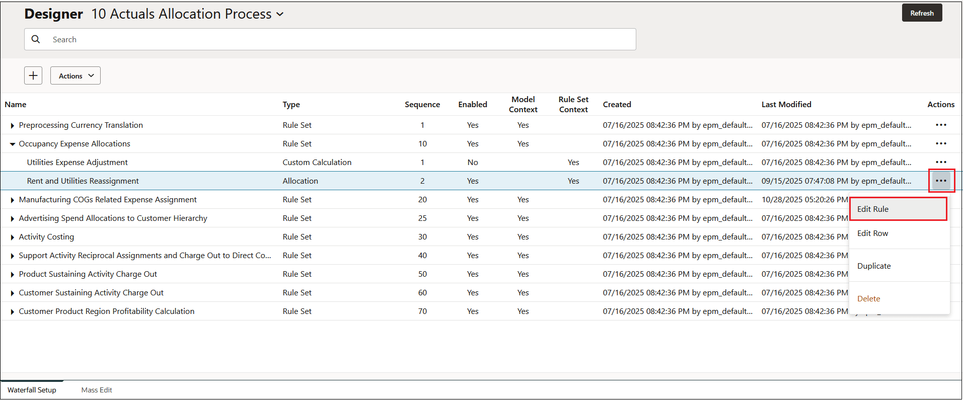

The rules defined in the Create Rule panel are displayed in the Waterfall Setup tab. Select the rule and click Edit to enter additional information about the source and destination, driver, and offset for the allocation rule.
Rent and Utilities Reassignment rule highlighted in the Waterfall Setup tab with the Edit Rule menu option selected
