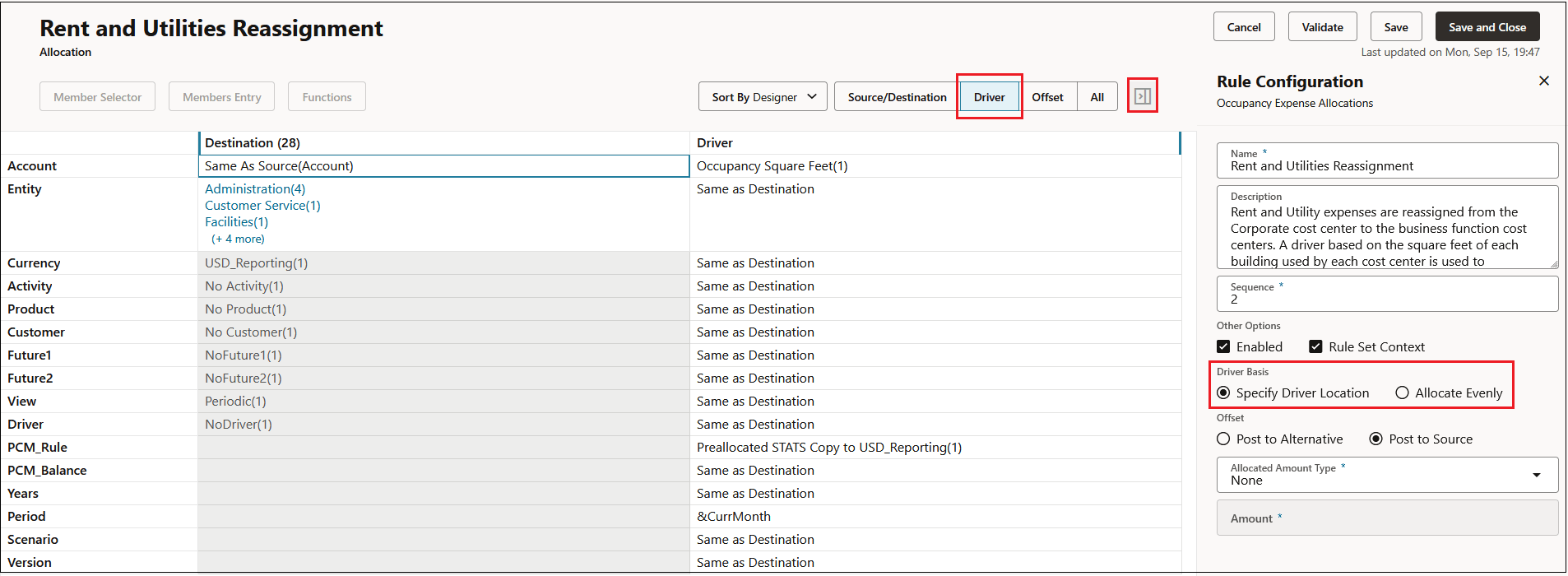

To define a driver, click Open Configuration icon to open the Rule Configuration panel, and select an option to specify how to allocate the data:
  • Specify Driver Location: Uses a driver to determine the percentages to allocate to each destination. If a destination has no driver value, then it receives no allocation.
  • Allocate Evenly: Allocates data evenly across all destinations.
Driver tab showing the Driver Basis options in the Rule Configuration panel
