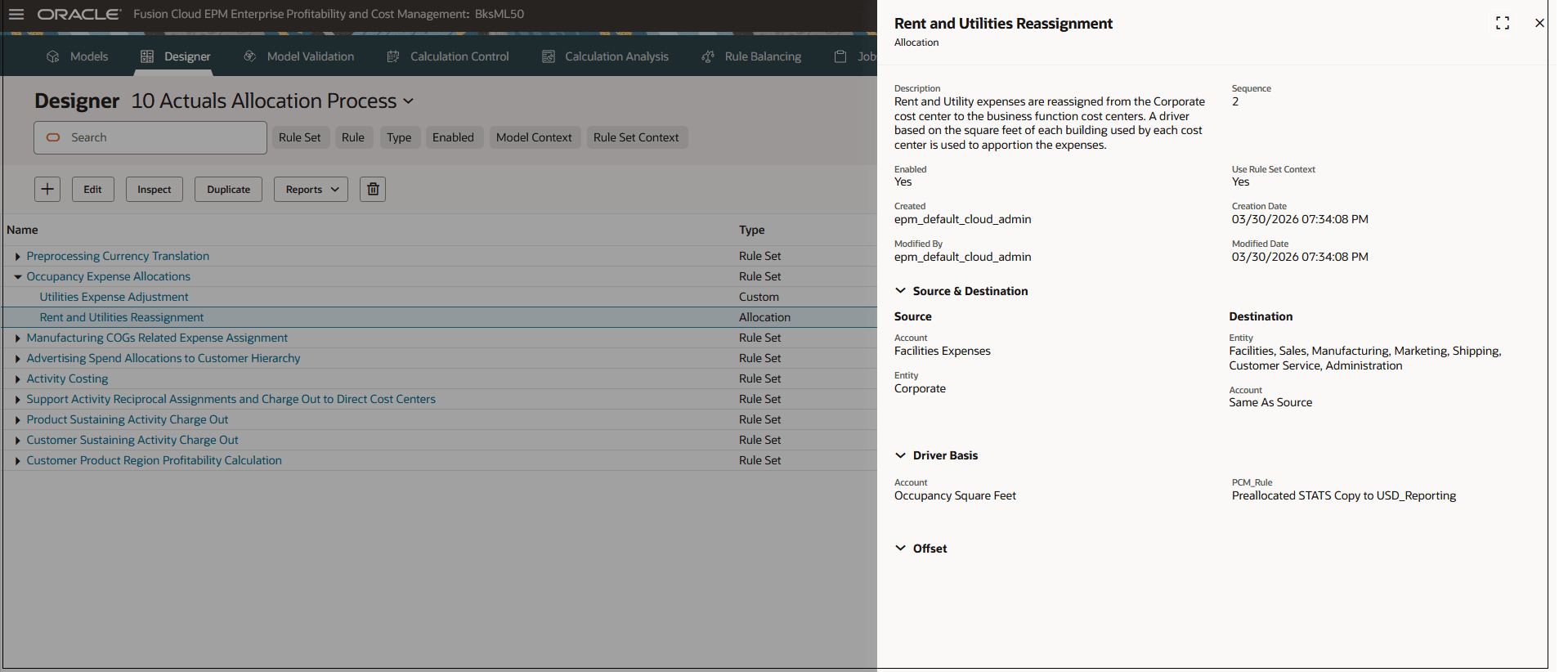

To display detailed information about a rule set or rule, select the rule set or rule and click Inspect. The details are dislayed in a pop-up window on the Waterfall Setup tab.
For example, the details about the Rent and Utilites Assignment rule in the BksML50 sample application provided with Enterprise Profitability and Cost Management are displayed as follows:
Waterfall Setup tab with detailed information about the Rent and Utilities Rezssignment rule displayed
Click Next icon and Previous icon at the top of the pop-up window to scroll forward and backward through the rules on the Waterfall Setup tab.
Click More Actions icon, and select Close or Maximize to either close or maximum the pop-up windows.
