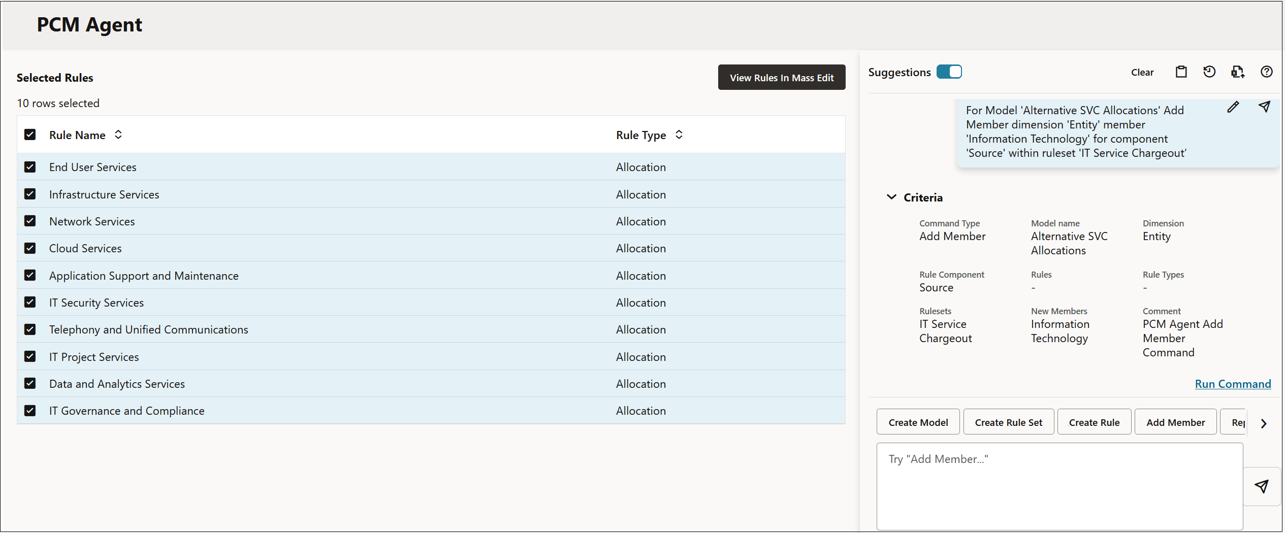

The following is an example of a user request to add a common member to several rules.
For Model 'Alternative SVC Allocations' Add Member dimension 'Entity' member 'Information Technology' for component 'Source'
within ruleset 'IT Service Chargeout’
After you enter the user request and click Send button (Send), the PCM Agent page is updated with the request information.
Figure 15-16 Add Member Preview
PCM Agent page showing the user request to add a member

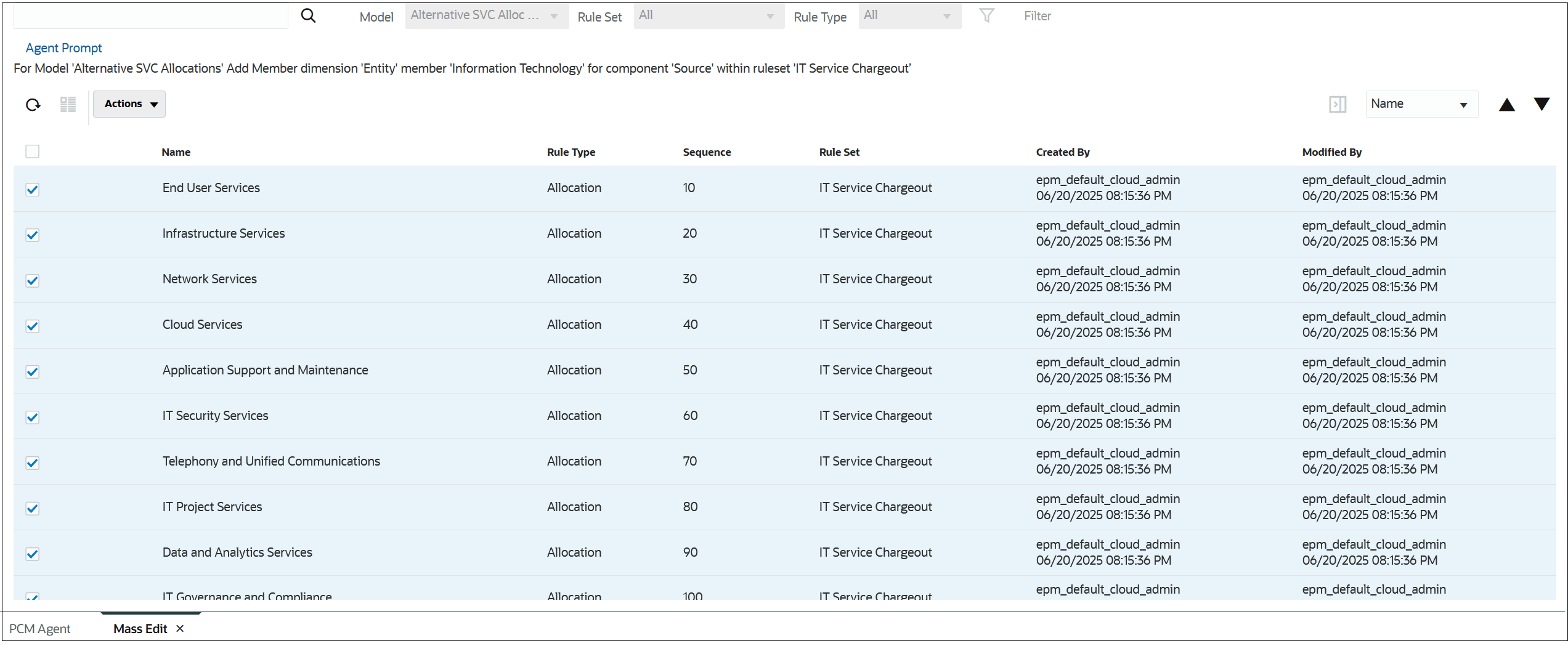

Click Run Command, and then click View Rules in Mass Edit to see the result of the request to add a member.
Figure 15-17 Add Member Result
Mass Edit tab showing the result of the user request to add a member
